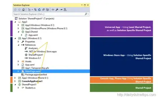

Here is a screen capture of the values:
So, how do I convert those bytes (or whatever they are) into something that I can stuff into a UIImage?

------------------------------------------------------- Adding a new image -----------------------------------------
Does this new image help?
