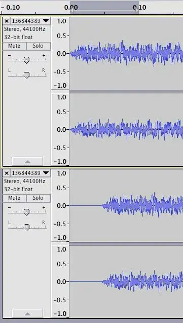

So, I converted both the original (128k aac in MPEG2 TS) and the transcoded (64k aac in aac/adts container) to WAV and put the two side-by-side. This is the result:
I'm not sure if this is representative of how a client will play it back, but it seems a bit odd that decoding the transcoded one introduces a gap at the start and makes the segment longer. Given they are both lossy encoding, I would have expected padding to be equally present in both (if at all).
