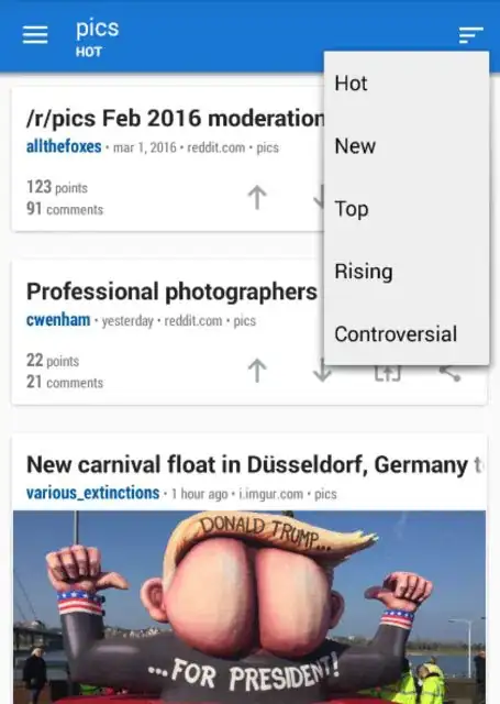

I am working on a app with action bar for navigation. Now I am trying to add a Spinner to the ActionBar.
I am able to get my custom icon on the ActionBar. But when I add entries into the spinner, the icon is hidden behind the selection box with first item selected.
I want to have only the icon in the ActionBar and the drop-down-list/spinner to appear when tapped on the icon.
