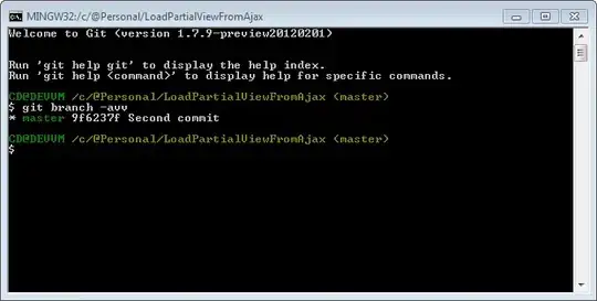

UPDATE
After running the git branch -avv command this is the result
