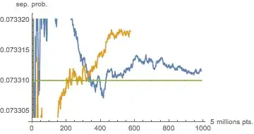

Use of the Inverse Symbolic Calculator (https://isc.carma.newcastle.edu.au) suggested the possible exact two-qubit separability probability of $\frac{629}{8580} =\frac{17 \cdot 37}{2^2 \cdot 3 \cdot 5 \cdot 11 \cdot 13} \approx 0.07331002$, quite close to the current estimate of ours, based on the largest sample, of 0.0733116 (employing 4,945,000,000 realizations of a quasirandom sequence of interest per the answer of Martin Roberts to https://math.stackexchange.com/questions/2231391/how-can-one-generate-an-open-ended-sequence-of-low-discrepancy-points-in-3d).
As the estimate further evolves, we may be led to modify/expand (if possible) upon this current "suggestion".
Here is a plot of estimates based upon two quasirandom sequences (one using $\alpha_0=0$ and one [the indicated longer one, using $\alpha_0 =\frac{1}{2}$] in the terminology of Roberts) along with the line $\frac{629}{8580}$.
