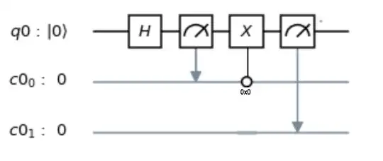

I am trying to make a quantum circuit with one qubit and 2 classical bits for each measurment in the system below: condition on the first measurment
I want to make condition on the first bit: if the first collapse to zero so x operator is act on the circuit, else (one) nothing is acting on the circuit.
I am using qiskit language.

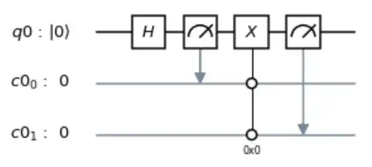

When I try to change
qc.x(q[0]).c[0]_if(c[0], 0)
with:
qc.x(q).c_if(c, 0)
I succeed in building my circuit but I get circuit that I don`t want to work with: Unwanted condition on measurment
I wish for help, thanks.

See the answer to this question for more on how the classical control works. Basically, your operations are controlled on the integer stored (in binary) across a register rather than on the individual bits themselves.
I also don't quite know the 'best practice' way of controlling on single bits, but I can tell you my workaround. Instead of creating a register with two bits, I create a list of two single qubit registers.
c = [ ClassicalRegister(1) for _ in range(2) ]
These can be added using the add method of a quantum circuit.
q = QuantumRegister(1)
qc = QuantumCircuit(q)
for register in c:
    qc.add_register( register )
Then it is possible to use your 'building the circuit' code can be done with
qc.h(q)
qc.measure(q,c[0])
qc.x(q[0]).c_if(c[0], 0)
qc.measure(q,c[1])
circuit_drawer(qc)
This works because c[0] now refers to a classical register, rather than a single bit from a classical register.
