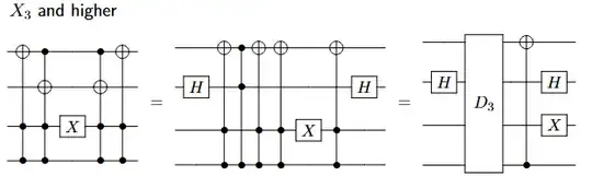

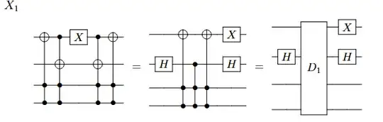

In the following cases, I'll draw the circuits on only 4 qubits, but the cases $X_i$ for $i\ge 3$ are similar. All gates other than $X$ and $H$ will have controls extending down to the remaining $n-4$ qubits. Note that a diagonal gate with controls (in the computational basis) remains a diagonal gate.
$X_2$ is trivially equal to $X_2 = H Z_2 H$.
From Lemma 2 all $D_i$s in the circuits above are in $\mathcal{CH}$. Then, we can see that all the permutations remaining in the circuits above are all diagonalizable by Clifford gates (Hadamards on targets) and are therefore semi-Clifford. Note Pauli $X$s on the right side of the circuit are Clifford and by Lemma 3 do not change membership in $\mathcal{CH}$. All such diagonal matrices are in $\mathcal{CH}$ since they only have entries $\pm 1$. In fact, all semi-Clifford permutations are in $\mathcal{CH}$ as shown here.
At this point we've shown that all individual terms $UX_i U^{\dagger}$ are in $\mathcal{CH}$. We need to show that all distinct products are also in $\mathcal{CH}$.
The product of distinct $PX_iP^\dagger$ and $PX_jP^\dagger$ is
$$(PX_iP^\dagger)(PX_jP^\dagger) = H_2 D_i Q_i H_2 H_2 D_j Q_j H_2 = H_2 D_i (Q_i D_j Q_i) Q_i Q_j H_2 = H_2 D Q_i Q_j H_2.$$
By repeatedly applying the equation above we can put any distinct product of $PX_iP^\dagger$s into the form above. We will use Lemma 4 to consider the diagonal and permutation cases separately. We see that $D$ is always in $\mathcal{CH}$ by group closure of the diagonal gates in $\mathcal{CH}$. $Q_i$ are permutations including the Pauli $X$ (see right side of circuit diagrams above). For all $i$, $Q_i = Q_i^\dagger$ so we have dropped the inverse in the equation above. We can ``pull'' the Pauli $X$s to one side by toggling controls between ON on 1 and ON on 0. Then, we are left with a product of commuting multi-controlled Toffoli gates, $Q_i Q_j$. The permutation $Q_i Q_j$ is again semi-Clifford (diagonalized by Hadamard) and must be in $\mathcal{CH}$. We can proceed to look at higher order products of $UX_i U^{\dagger}$ and see that they always have this form. We conclude that the entire gate family is in $\mathcal{CH}$.
