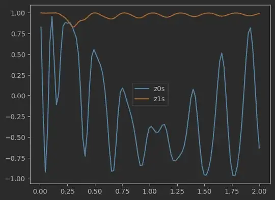

This is the case when I do: rabi_oscillations(time_duration=0.5, max_amplitude=10): result1

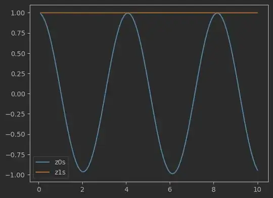

But things mess up if I increase time duration, for instance rabi_oscillations(time_duration=10, max_amplitude=2): result2

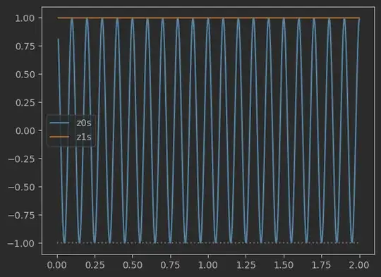

or decreasing the amplitude range:
result2max

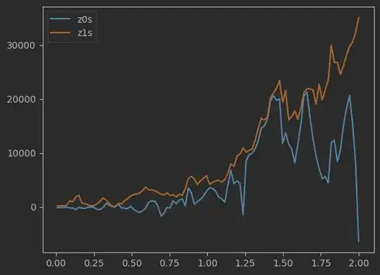

According to ParametrizedEvolution Pennylane class (which is in charge for solving the Schrödinger evolution when calling qml.evolve), the default value is 1.4e-8. If I decrease this tolerance, I do not get a different plot than the ones I displayed above (I did up to atol=1e-20). I think that very small values of atol mess things up even more, since atol=1-30 returns nan for z0s and z1s arrays, and atol=1e-25 returns some nan values as well. However, I am sure changing atol has some effects on solutions because setting atol=1e-4 returns awful solutions (probabilities beyond 1):
awful

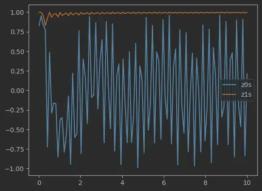

Regarding a), I decreased $g$ to g = 1e-5 / (2 * jnp.pi) and I stil get crazy behaviour of qubit 0 (and now qubit 1 is not perturbed). Here is the corresding evolution ( rabi_oscillations(time_duration=10, max_amplitude=2)):
sol a
