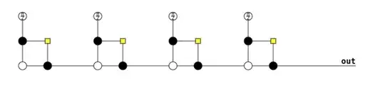

Interestingly, when distilling $|i\rangle$ states instead of EPR pairs, it is possible to just keep folding high-error states into a low-error state (assuming postselection keeps succeeding). I think this is because $|i\rangle$ is an eigenstate of Y, meaning it's immune to Y errors, so it's fine that there's a high noise basis when comparing states. Just make the noise basis the Y basis, and that noise becomes irrelevant due to the state being distilled. Here's a ZX graph of the streaming $|i\rangle$ distillation (where the $\pi/2$ should be interpreted as noisy, and everything else is perfect):
Just keep repeating that little widget to make the output arbitrarily good.
