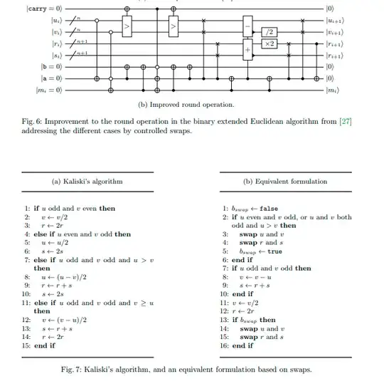

I don't think that doing a modular exponentiation under superposition will be cheaper than the standard technique of doing an extended binary gcd under superposition, such as in Figure 6/7 of "Improved quantum circuits for elliptic curve discrete logarithms".
