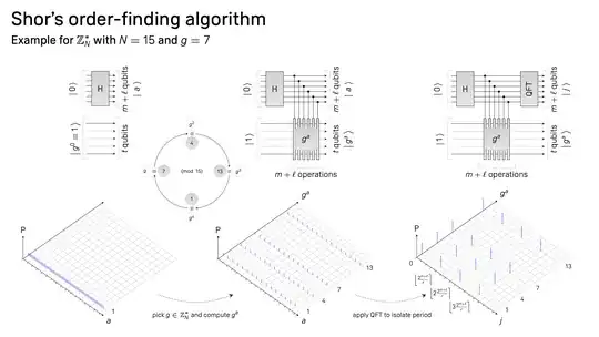

To illustrate with a slide from one of my lectures (with $m = \ell = 3$):
If you post-process $j$ by expanding $\frac{j}{2^{m+\ell}} = \frac{j}{2^6}$ in a continued fraction, you will find
  • $0$ when $j = 0$ (no solution),
  • $2$ (as yielded by the fraction $\frac{1}{2}$) when $j = 32$ (you found a divisor of $r$), and
  • $4$ (the correct order, as yielded by the fraction $\frac{1}{4}$ or $\frac{3}{4}$) when $j \in \{16, 48\}$.
Provided you found $r$, you can factor by computing $\text{gcd}(g^{r/2} \pm 1, N)$ as proposed by Shor.
