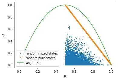

That said, it does seem to hold at least for two-qubit states. Note that for pure states the concurrence is defined as such that $C^2=2(1-p)$ with $p=\operatorname{tr}(\rho_A^2)$ with $\rho_A\equiv\operatorname{tr}_B(\rho)$. And obviously $2(1-p)\le 4p(1-p)$ for all $p\in[1/2,1]$. For mixed states the concurrence is defined via convex roof extension so if it holds for pure states I think it has to hold for all mixed states as well.
I should add though that it's a completely useless (if true) inequality. You might as well just use $C^2\le 2(1-p)$ which is easier and tighter.
Here's a some quick and dirty numerics of how the quantities are related:

    # plot the data in `data` together with the C^2=4p(1-p) curve with p purity and C concurrence
    fig, ax = plt.subplots()
    ax.plot(data[:, 0], data[:, 1]**2, 'o', markersize=2, label='random mixed states')
    ax.plot(data_pure[:, 0], data_pure[:, 1]**2, 'o', markersize=2, label='random pure states')
    p = np.linspace(0, 1, 100)
    ax.plot(p, 4*p*(1-p), label=r'$4p(1-p)$')
    ax.set_xlabel(r'$p$')
    ax.set_ylabel(r'$C^2$')
    ax.legend()
    plt.show()
