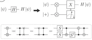

It follows the protocol for Hadamard gate injection:
Considering that $H \simeq \sqrt{Z}\sqrt{X}\sqrt{Z}$, it should be equivalent to inject $\sqrt{X}$ wrapped between $\sqrt{Z}$ gates.
I am led to think that $\sqrt{X}$ injection is possible, with some protocol that is somehow complementary to the $\sqrt{Z}$ injection.
However, I can't find it. Is it possible?

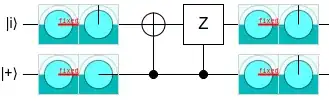

Note that you can replace $|i\rangle = |0\rangle + i|1\rangle$ with a $|+\rangle$ state followed by $\sqrt{Z}$, if needed. Also note that it's possible to duplicate $|i\rangle$ states by using RX,CX,CZ:
Also here's how you do a Hadamard with fewer gates:
assert stim.Circuit("""
    RX 1
    CX 1 0
    CZ 1 0
    MX 1
    Z 0
    CY rec[-1] 0
""").has_all_flows([
    stim.Flow("X0 -> Z0"),
    stim.Flow("Z0 -> X0"),
