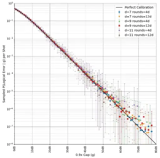

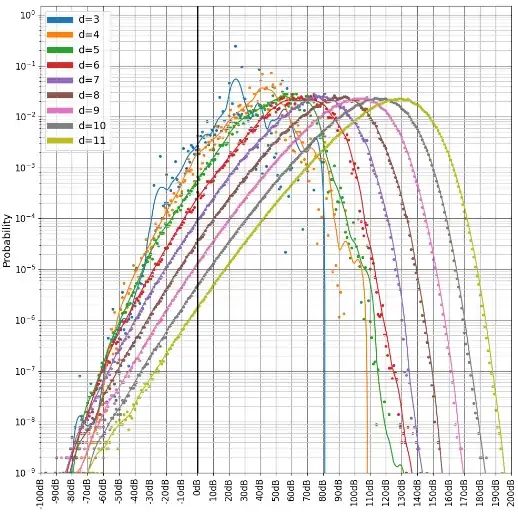

For example, this is how we computed the complementary matchings in "Yoked Surface Codes". You can see me inverting the extra detector in the source code here. We also did some statistics on the gaps, showing they're well behaved:

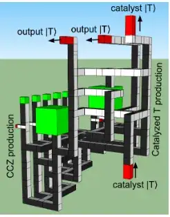

There are a few problems with this approach to computing the gap, when you start trying to do this for circuits more complicated than memory experiments (e.g. magic state distillation):
  1. You need to identify all the topologically distinct boundaries. This is tedious. Go on, count them:
