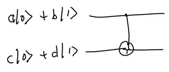

Suppose we have a 2 qubit circuit as follows:
Before the CNOT gate, the tensored state distribution is
$$(a|0\rangle + b|1\rangle)(c|0\rangle + d|1\rangle) = ac|00\rangle + ad|01\rangle + bc|10\rangle + bd|11\rangle$$

After the CNOT gate however, the state distribution becomes:
$$ac|00\rangle + ad|01\rangle + bc|1\color{red}1\rangle + bd|1\color{red}0\rangle$$
Suppose we now measure $q_2$ after applying CNOT, then the remaining uncollapsed state of $q_1$ becomes
Case $q_2=|0\rangle$:
$$\Psi_1 = ac|0\rangle + bd|1\rangle$$
Case $q_2=|1\rangle$:
$$\Psi_1 = ad|0\rangle + bc|1\rangle$$
so $a,b,c,d$ has now become hopelessly entangled into the state of $\Psi_1$, despite $\Psi_1$ acting as merely the control (not target) of the CNOT operation...
