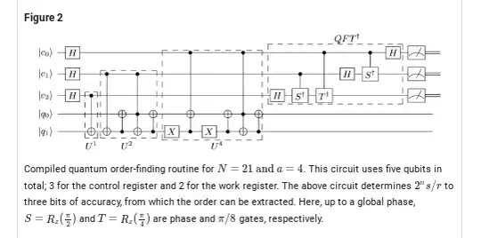

For instance,
(from https://www.nature.com/articles/s41598-021-95973-w)
uses a very specific circuit that outputs a hard-coded
$$ 4^j \mod{21}$$
while already pre-knowing that the period is 3; thus it is pre-known that a 2 qubit modulo-container register is enough to handle the output period of:
$$4^0 = 1 \mod{21}$$ $$4^1 = 4 \mod{21}$$ $$4^2 = 16 \mod{21}$$ $$4^3 = 1 \mod{21}$$

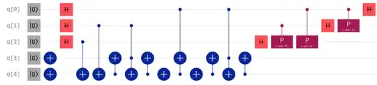

The three residues are further encoded into 2-bit modulo containers as
$$ 1 \mod{21} \rightarrow |11\rangle$$ $$ 4 \mod{21} \rightarrow |10\rangle$$ $$ 16 \mod{21} \rightarrow |01\rangle$$

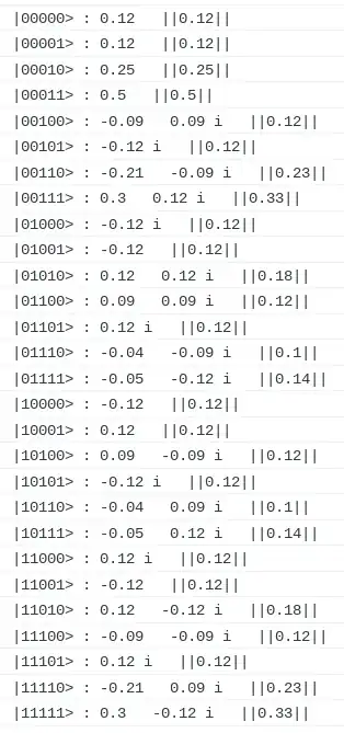

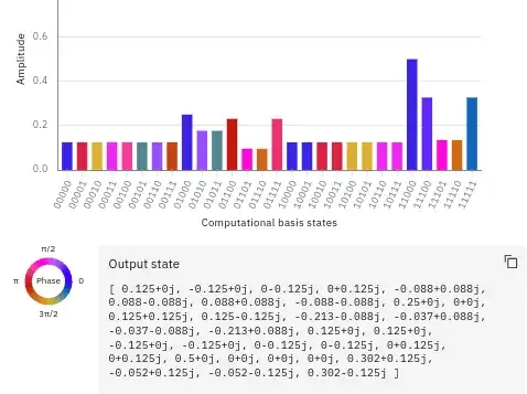

only approximately correctly as a waveform:
The final probability spike is not completely clean either:
Thus, the main difficulty in factoring seems to be in implementing an all-purpose circuit for outputing
