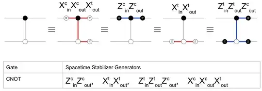

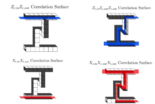

The trick to proving surface code constructions are correct is to draw them as topological defect diagrams, find the correlation surfaces these diagrams support, and check that those surfaces propagate identically to the stabilizer flows of the desired operation. I don't know of a paper that explains this, but I've given a talk on it (video) (slides).
The benefit of this style of proof is that it's efficient to compute (scales to tens of thousands of logical qubits), it generalizes across styles of surface code computation (braiding vs lattice surgery vs others), and it's invariant under topological deformations and spacetime rotations.
For an $XX$ parity measurement, the relevant surfaces you must show exist are:
$X_1 \rightarrow X_1$
$X_2 \rightarrow X_2$
$Z_1Z_2 \rightarrow Z_1Z_2$
$X_1 X_2 \rightarrow I$
