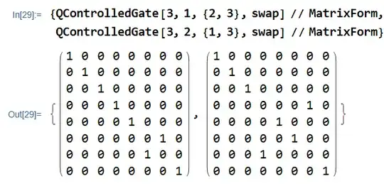

As per how you'd actually implement this, there's of course several approaches. Here's a Mathematica snippet I wrote many years ago to achieve this. Looking back at this, it's probably that you can make this more efficient by multiplying by permutation matrices as discussed in the post above, rather than shuffling indices as done in the code; still, it works in at least simple scenarios, so I haven't had the incentive to change it:
QBasePermutation[
  matrix_?MatrixQ,
  basisLengths : {__Integer},
  newIndices : {__Integer}
] := Module[{matrixAsTP, transposedTP},
    (* Convert matrix to TensorProduct structure *)
    matrixAsTP = ArrayReshape[matrix, Join[#, #] & @ basisLengths];
    (* Properly transpose the indices *)
    transposedTP = Transpose[matrixAsTP,
      Join[newIndices, newIndices + Length @ basisLengths]
    (* Convert back into matrix structure *)
    Flatten[transposedTP,
      {#, # + Length @ basisLengths}& @ Range @ Length @ basisLengths
ProjectionMatrix[dim_Integer, y_Integer, x_Integer] := Normal @ SparseArray[ {{y, x} -> 1}, {dim, dim} ];
ProjectionMatrix[dim_Integer, x_Integer] := ProjectionMatrix[dim, x, x];
KP[x_] := x; KP[x___] := KroneckerProduct @ x;
QControlledGate[numQubits_Integer, controlQubit_Integer, targetQubits_List, gateMatrix_] /; ( And[ 1 <= controlQubit <= numQubits, Sequence @@ Thread[1 <= targetQubits <= numQubits], Sequence @@ Thread[targetQubits != controlQubit] ] ) := Module[{gate}, gate = Plus[ KP[ProjectionMatrix[2, 1, 1], IdentityMatrix[2 ^ Length @ targetQubits]], KP[ProjectionMatrix[2, 2, 2], gateMatrix] ]; gate = KP[gate, IdentityMatrix[2 ^ (numQubits - Length @ targetQubits - 1)]];
QBasePermutation[gate, ConstantArray[2, numQubits], {controlQubit, Sequence @@ targetQubits, Sequence @@ Complement[ Range @ numQubits, Append[targetQubits, controlQubit] ] } ] ];
QControlledGate[ numQubits_Integer, controlQubit_Integer, targetQubits_Integer, gateMatrix_ ] := QControlledGate[numQubits, controlQubit, {targetQubits}, gateMatrix];
swap = {{1, 0, 0, 0}, {0, 0, 1, 0}, {0, 1, 0, 0}, {0, 0, 0, 1}};
Which gives: enter image description here
