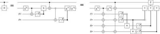

I need to perform a controlled-$H$ gate, which is non-Clifford.
Its standard decomposition is $$Y^{-\frac{1}{4}}_b\cdot CX^{\phantom{\frac{1}{4}}}_{a,b}\cdot Y^{\frac{1}{4}}_b.$$
By means of some auxiliary qubits, one should be able to inject a $Y^{\frac{1}{4}}$ ($Y^{-\frac{1}{4}}$) gate.
What is a possible circuit implementation for this?

You can do $Y^{1/4}$ the same way you do $Z^{1/4}$, by consuming a $|T\rangle$ state.
