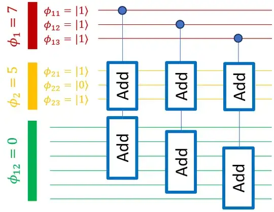

I have modified a quantum-quantum multiplication operator to do what you're looking for.
Quantum-quantum multiplier
for i in range(length(\phi_1)):
    output_subregister = \phi_{12}[i:i+length(\phi_1)+1]
    if \phi_1[i] == 1:
        output_subregister += \phi2
We can start from this quantum-quantum multiplier, which pseudocode is given above. Adding $\phi_2$ to a subset of qubits in $\phi_{12}$ like such, will successively add $2^{i-1}\phi_2$ to the register $\phi_{12}$, controlled by the $i^{th}$ qubit in register $\phi_1$. For those unfamiliar, this is because the product $\phi_1 \phi_2$ can be decomposed into the sum $\phi_2(2^0\phi_{11} + 2^1\phi_{12} + ... 2^{n-1}\phi_{1n}$), where $\phi_{1i} \in \{0,1\}$ is the state of the $i^{th}$ qubit in $\phi_1$. This produces the state $|a,b,0\rangle \rightarrow |a,b,ab\rangle$.
Example implementations of the addition operation are described in these two papers: https://arxiv.org/pdf/quant-ph/0008033 or https://arxiv.org/pdf/quant-ph/9511018. Note the +1 qubit in the output_subregister - that is to account for the fact that an addition of two $n$-bit numbers might potentially produce a $(n+1)$-bit result.

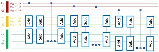

To uncompute the control qubit $\phi_{1i}$ at the $i^{th}$ step of the iteration, we can utilize two observations:
  1. At the start of the iteration step (before adding $\phi_2$), output_subregister will always store a value less than $\phi_2$. This can be verified by noticing that the current cumulative sum in the entire $\phi_{12}$ register will be $\phi_2(2^0 + 2^1 + ... 2^{i-1})$. The value in the subregister will be a right bit-shift of this value by $i$ bits, which will be $\leq\phi_2(2^{-i} + 2^{-i+1} + ... 2^{-1})$.
  2. When subtracting a $b$ from $a$ using an inversion of either of the two examples of the quantum adders described above (using negative angles in https://arxiv.org/pdf/quant-ph/0008033, reversing the order of all gates in https://arxiv.org/pdf/quant-ph/9511018), an underflow will occur when $b>a$. This is indicated by the most significant $(n+1)$ qubit in the output register being in the $|1\rangle$ state.
Considering these two, we can subtract $\phi_2$ from the subregister of $\phi_{12}$ to "test" whether the control qubit $\phi_{1i}$ was in the $|1\rangle$ state. If $\phi_{1i}$ was in the $|1\rangle$ state, $\phi_2$ would have been previously added to the output subregister, and subtracting $\phi_2$ at this step would leave the value positive. Whereas if $\phi_{1i}$ was in the $|0\rangle$ state, subtracting $\phi_2$ would cause an underflow and result in the most significant $(n+1)$ qubit in the result subregister to be $|1\rangle$. We can use this qubit to control a CNOT applied on the control qubit, to set it to $|0\rangle$ if it was previously $|1\rangle$. This effectively erases the value stored in $\phi_1$ as we proceed along in calculating the product $\phi_1 \phi_2$. This produces the state $|a,b,0\rangle \rightarrow |0,b,ab\rangle$. We can very well swap the first and third register to get the state you want.
    if \phi_1[i] == 1:
    output_subregister -= \phi2
    if output_subregister[-1] == 0:  #indicates an underflow from the previous subtraction
    #Occurs only if \phi2 was added, which means \phi_1[i] == 1
        \phi_1[i] = NOT \phi_1[i]

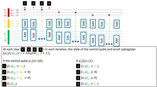

Quantum-quantum in-place multiplier
We can trace the states throughout one step of the iteration and verify it is indeed what we want for both possible values of the control qubit in superposition. enter image description here
