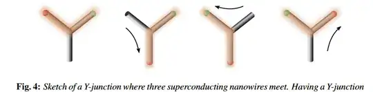

If you go to some random Majorana paper or talk, you will find a diagram like this one. Note that the diagram is using lines. Making the lines longer should exponentially increase the error suppression:

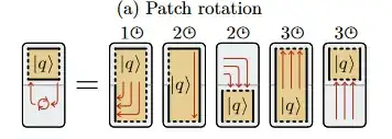

If you go to some random surface code paper or talk, you will find a diagram like this one. Note that the diagram is using square patches. Increasing the diameter of the patches should exponentially increase the error suppression:

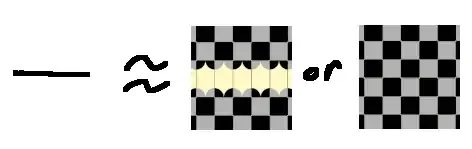

The lines in the majorana diagrams are not analogous to 'regions of surface code'. Instead, they are analogous to the domain walls between twist defects. Or rather, they are like optional domain walls. It's a place where you can have the normal surface code checkerboard pattern, or you can have stabilizers that stretch across two tiles:

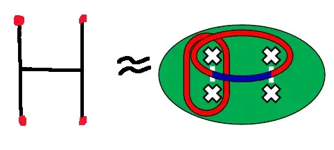

So a four-majorana "tetron", when it's "turned on", is like a logical qubit defined by four twists and two domain walls:
Correspondingly, it would in fact be a problem if you put the ends of disjoint nanowires too close together (modulo details about what they are deposited onto). Because if you put the twist defects at the ends of domain walls too close together, that introduces low distance logical errors.
So even though we are drawing lines, they need a minimum amount of spacing. Which makes them pack like squares, which resolves the asymptotic difference in scaling of size vs error suppression.
