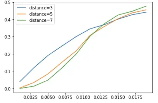

Here's an example of a surface code with rounds = 3 * distance as in the stim example:

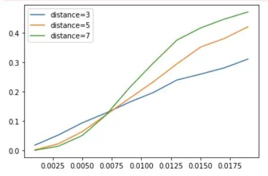

and here's one with rounds=20:
The x axis are physical (2 qubit gate) error rates, and the y axis is logical error rate

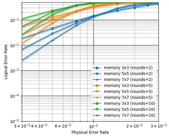

You can very clearly see the problem at low round numbers. The threshold for 2-round memory experiments is higher than for 5-round memory experiments which is higher than for 10-round memory experiments. Here's data I took which agrees with your data. Note how the three curve groups have their respective crossings at different horizontal locations:
Incidentally, this is one of the reasons error correction experiments that do repetitive measurement instead of a single-shot thing are much more impressive. Single-shot experiments are like setting the number of rounds to 1, and have a much easier threshold.
