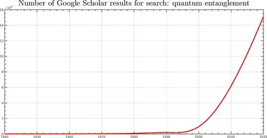

However the use of the term as found by searching: quantum entanglement
in Google Scholar indicates that the term was merely doubling every 10 years until roughly 1990 when it went up by a factor of 5 in a 10-year period, followed by further factor of 6 in the next 10-year period:
Data was collected just now:
1900-1940: 63 results
1900-1950: 93 results
1900-1960: 146 results
1900-1970: 313 results
1900-1980: 718 results
1900-1990: 1700 results
1900-2000: 9380 results
1900-2010: 61700 results
1900-2020: 151000 results
