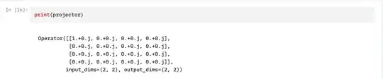

So, there actually is a method called to_operator() for the class Statevector which takes a statevector and converts it into a projector operator. Here is the code to write your specific projector operator:
from qiskit.quantum_info import Statevector
zero = Statevector([1,0])
zero_state = zero.tensor(zero) # or zero_state = Statevector([1,0,0,0])
projector = zero_state.to_operator()
As you can see, you can input a state as a python list, or as a numpy array. If you print this projector, you will get the following output:What a projector operator looks like.
Then, after making your operator, you can use the method evolve() to apply the projector operator on a statevector:
statevector.evolve(projector)
