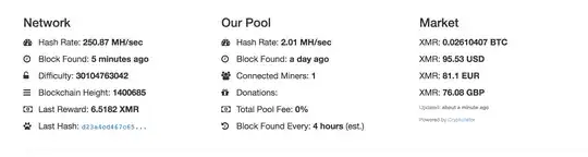

Here are my pool stats(private pool): screen with hashrate and other info about pool

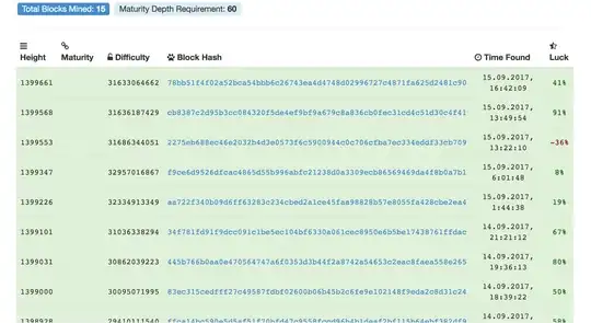

Here are the stats before the fork: stats before fork

At 2.01 MH/sec your pool is currently under 1% of the total network hashrate. It is possible your pool has just been very unlucky since the fork. Normal variance can cause your expected 4 hour mined block frequency to vary widely at times.
