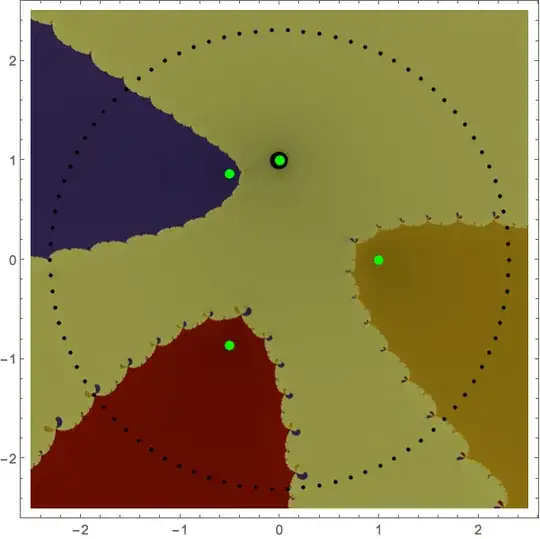

Here's a picture that further illustrates what's going on with this example:
The large green dots are exactly the roots of the polynomial - each living inside its shaded basin of attraction. The fundamental observation in the paper is that each of these basins of attraction extends off to infinity. As a result, we can choose a large enough ring of initial seeds so that each basin of attraction contains one of the seeds. The ring for this particular polynomial (in fact, any polynomial of degree six with roots in the unit disk) is shown as the ring of black dots.
