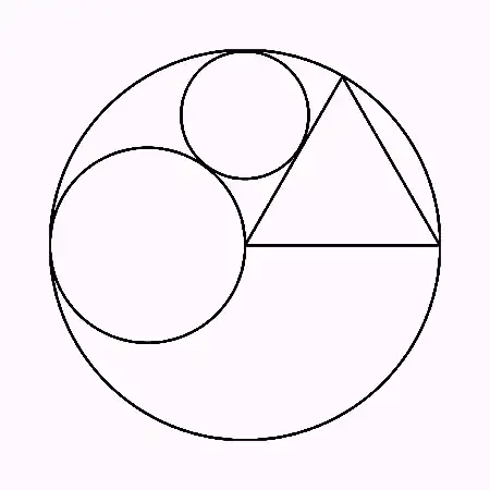

"From a 1803 Sangaku found in Gumma Prefecture. The base of an isosceles triangle sits on a diameter of the large circle. This diameter also bisects the circle on the left, which is inscribed so that it just touches the inside of the container circle and one vertex of the triangle. The top circle is inscribed so that it touches the outsides of both the left circle and the triangle, as well as the inside of the container circle. A line segment connects the center of the top circle and the intersection point between the left circle and the triangle. Show that this line segment is perpendicular to the drawn diameter of the container circle. (T. Rothman)"

Note 1: The radius of the smaller circle touching the left vertex of the triangle is not necessarily half the radius of the enclosing circle. There IS variability in the base of the triangle.
Note 2: Two of the vertices of triangle necessarily are on the enclosing circle.

  • I presume you don't want the use of coordinates here? – J. M. ain't a mathematician Dec 22 '11 at 02:35
  • @J.M. - No coordinates. Synthetic proofs only. – dsg Dec 22 '11 at 03:19
  • Another presumption: The apex of the triangle lies on the circle. (The picture suggests this, but the description doesn't say so.) Otherwise, take the extreme case of a triangle with zero height and base equal to the big circle's radius; the top circle would be tangent to the diameter at a point somewhat to the right of center, so that the line joining the top circle's center the point of intersection (the big circle's center) would NOT be perpendicular to the diameter. – Blue Dec 22 '11 at 05:00
  • @Day: The triangle is isosceles. I was assuming that, regarding the apex lying on the circle, the text is authoritative and the diagram is misleading, since otherwise the problem would be rather trivial. – joriki Dec 22 '11 at 05:03
  • @joriki: But, then, what about my zero-height triangle counter-example? (And, regarding being trivial with the apex on the circle: is it? I agree that it would be if we knew that the the base took up exactly half of the diameter --as it seems in the diagram-- but we aren't guaranteed that ... and I'd think the triangle would've been described as equilateral in that case. The variability of the base seems to be what makes this problem interesting.) – Blue Dec 22 '11 at 05:14
  • @Day: I see -- I think you're right and I was confused. – joriki Dec 22 '11 at 05:17

Let $A$ be the big circle with centre $O$ and diameter $PQ$
Let $B$ be the circle internally tangent to $A$ at $P$ and intersecting $PQ$ again at $M$
Let $R$ be on $A$ such that $\overline{MR} = \overline{QR}$
Let $C$ be the circle that is tangent to $A$, $B$, $MR$ and inside $A$ and outside both $B$ and completely on the same side of $PQ$ as $R$
Invert at $M$, mapping $P$ to $Q$
Then $A$ maps to $A$, $B$ maps to the line $T$ that is tangent to $B$ at $Q$, $MR$ maps to $MR$, and thus $C$ maps to the circle $D$ that is tangent to $A$, $T$, $MR$ and outside $A$ and on the same side of $T$ as $M$ and completely on the other side of $PQ$ as $R$
Let $K$ be the point on $MQ$ such that $RK \perp MQ$
Let $N$ be the point such that $PQ \perp MN$ and $\overline{MN} = 2\overline{MR}$ and $N$, $R$ are on the opposite side of $PQ$
Let $X$ be the intersection of $NO$ and $A$ between $N$ and $O$
Let $Y$ be the point on $T$ such that $NY \perp T$
Let $Z$ be the point on $MR$ such that $NZ \perp MR$
Let $\overrightarrow{MO} = r \overrightarrow{OQ}$ and WLOG $\overline{OQ} = 1$
Then $\overline{MR}^2 = \overline{RK}^2 + \overline{MK}^2 = \overline{OR}^2 - \overline{OK}^2 + \overline{MK}^2 = 1 - (\frac{1-r}{2})^2 + (\frac{1+r}{2})^2 = 1+r$
Thus $\overline{NO}^2 = \overline{MN}^2 + r^2 = 4 \overline{MR}^2 + r^2 = 4+4r+r^2 = (2+r)^2$
Thus $\overline{NX} = (2+r)-1 = \overline{MQ}$
Also it is clear that $\overline{NY} = \overline{MQ}$
Also since $\triangle MNZ \sim \triangle RMK$, $\overline{NZ} = 2 \overline{MK} = \overline{MQ}$
Since $D$ is uniquely defined and $N$ is the centre of an identically defined circle, $N$ is the centre of $D$
Since the centres of $C$ and $D$ are collinear with $M$, the centre of $C$ lies on $MN$, therefore the line through both $M$ and the centre of $C$ is perpendicular to $PQ$
(QED)
Note that the same solution applies to both cases where $C$ is on either side of $PQ$, with very minor changes. Inversion seems to simplify most of these kind of questions. Quite a few can be found online.

For those who do not like inversion... =P
Let $B$ be the circle internally tangent to $A$ at $P$ and intersecting $PQ$ again at $M$ and having centre $J$
Let $D$ be the circle tangent to $B$ and $MR$ with centre $N$ such that $PQ \perp MN$ and $N$,$R$ are on the same side of $PQ$
Let $Z$ be the point where $D$ is tangent to $MR$
Let $x = \overline{MN}$
Let $y$ be the radius of $D$
Since $\triangle MNZ \sim \triangle RMK$, $\frac{x}{y} = \overline{MN} / \overline{NZ} = \overline{RM} / \overline{MK} = \sqrt{1+r} / \frac{1+r}{2} = \frac{2}{\sqrt{1+r}}$
Thus $(1+r)x^2 = 4y^2$
Also $(y+\frac{1-r}{2})^2 = \overline{NJ}^2 = \overline{MN}^2 + \overline{MJ}^2 = (\frac{1-r}{2})^2 + x^2$
Thus $(1+r)y^2 + (1+r)(1-r)y = (1+r)x^2 = 4y^2$
Since $y\not=0$, $(3-r)y = 1-r^2$
$\overline{OQ} = y + \overline{ON}$
$\Leftrightarrow (1-y)^2 = \overline{ON}^2 = \overline{MN}^2 + \overline{MO}^2 = x^2 + r^2$
$\Leftrightarrow (1+r)(1-2y+y^2) = 4y^2 + (1+r)r^2$
$\Leftrightarrow (3-r)y^2 + (2+2r)y - (1+r)(1-r^2) = 0$
$\Leftrightarrow (1-r^2)y + (2+2r)y = (1+r)(1-r^2)$
$\Leftrightarrow (1+r)(3-r)y = (1+r)(1-r^2)$ which is clearly true
Thus $D$ is tangent to $A$
Since $C$ is uniquely defined and $D$ is an identically defined circle, $N$ is the centre of $C$
Therefore the line through both $M$ and the centre of $C$ is perpendicular to $PQ$
(QED)
