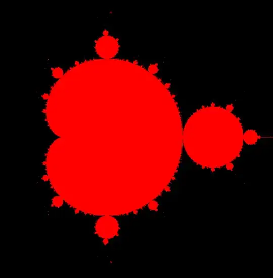

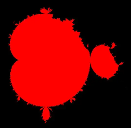

Likewise, we can plot over transpositions of the 4 variables. Here is what happens when we plot over the last two variables (the first picture has variables 1 and 2 near zero, and the second has variables 1 and 2 being nonzero):
The first looks like the Mandelbrot set, and the second looks like what it would look like if the mathematician were hungry, and decided to take a large bite out of it.

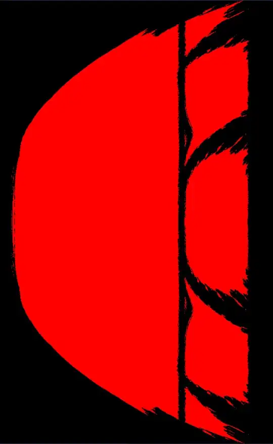

And here's an example of what it looks like when we plot over variables 2 and 4:
So it (visually, at least) looks like the filled Julia and Mandelbrot sets are just slices through a 4-dimensional solid, taken at different angles.

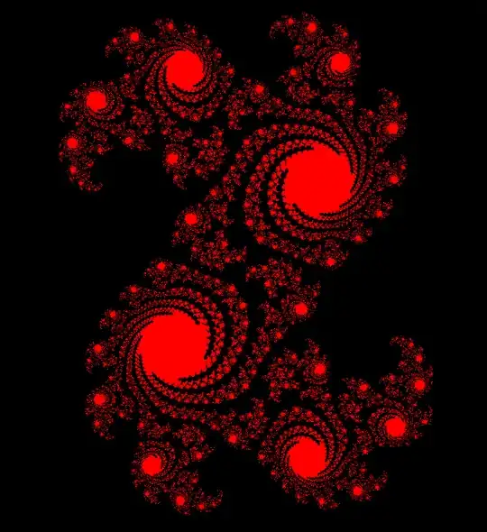

Numerically integrating over variables 3 and 4 yields this:
What on Earth is it?
EDIT: Apparently I'm mentally retarded; there was a bug in my code, and the previous image is an error (albeit an interesting-looking one). This is what the projection of $d_{x,y,z,w}$ on coordinates 3 and 4 really looks like:
Here's a bigger version (right-click and open in new window to get full size):

Similarly, a point $c$ is in the Mandelbrot set iff $\chi(c,0)=1$, which explains your Mandelbrot set images. Note that the $0$ is not arbitrary. The whole point of the Mandelbrot set is to help us classify Julia sets and that classification is based on the orbit of the critical point of the function which, for $f_c$, is always zero. Now, if you change the zero to some nearby point $z_0$ to examine $\chi(c,z_0)$, then I suppose you generate something close to the Mandelbrot set but not necessarily something very enlightening. This explains your Mandelbrot set with a "bite out of it".

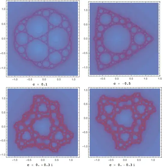

Finally, your $g_c(z)=z^2+c/z$ is potentially very interesting but likely requires much more careful analysis. You're no longer dealing with polynomials but more general rational functions and to obtain truly interesting results, you'd need to deal properly with the point at infinity and analyze the critical points of $g_c$, of which there are three. The notion of a "filled" Julia set really makes no sense in this context, but the notion of the Julia set as the closure of the set of repelling periodic points makes perfect sense. Here are a few images of Julia set from this family generated by Mathematica's JuliaSetPlot command, which is new in V10:
