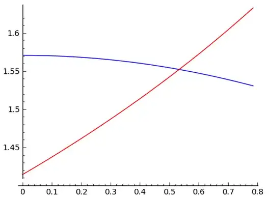

For completeness, I add some numerical details to the excellent answer by Noam D. Elkies. Let $C$ be the cone such that the lateral surface unrolls to a circular sector of angle $2\theta$. There are two sources of distortion:
  • Between two points on lateral surface (worst case: same level, diametrally opposite). This gives $c\ge (\pi/\theta) \sin(\theta/2)$, blue curve below.
  • Between points on lateral surface and on the base (worst case: they are equally distant from the edge). This gives $c\ge \sqrt{2\pi/(\pi-\theta)}$, red curve below.
distortion

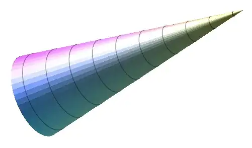

The distortion is minimized when the curves intersect, $\theta\approx 0.53378$. This corresponds to the cone of radius $\approx 0.1675$ at height $1$; pretty sharp indeed.
cone
This least-distorted cone has $c\approx 1.5522$, beating the sphere for which $c=\pi/2 \approx 1.5708$.
