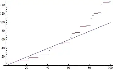

Define the function $f$ to be $$f(x) = C + \sum_{j = 1}^N \left\lfloor \frac{x}{P_j} \right\rfloor C_j.$$ We are trying to solve $$Q = f(Q)$$ which is a fixed point equation. The function $f$ is monotonically increasing. To get some feel for it, let's consider the example $C = 11$, $N = 10$, $P_j = 10 j + 1$ and $C_j = 2 j$. We draw the graph of $y = f(x)$ and $y = x$, and observe where they intersect (magenta is $f$):
graph of f
As you see, there are several solutions. There is a well-known method for finding fixed points of functions:
  1. Start with an arbitrary approximation, say $X_0 = 0$
  2. Define $X_{k+1} = f(X_k)$
  3. Keep computing $X_0$, $X_1$, $X_2$, ... until you get $X_{k+1} = X_k$, or at least $|X_{k+1} - X_k| < \epsilon$ for an acceptably small $\epsilon$.
There is no guarantee the process will actually find a fixed point, but at least in our case it does, we get: $X_0 = 0$, $X_1 = 11$, $X_2 = 13$, $X_3 = 13$, so $X = 13$ is a solution. Depending on what your $P_j$ and $C_j$ look like this method may work well.

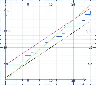

My proposal:
[For the sake of brevity the unknown $q_i(x)$ is denoted $Q$ and $c_i(x)$, $C$.] All constants can be real.
The right hand side is a sum of regular staircase functions, with the steps having width $P_j$ and height $C_j$. You can construct the resulting sum for increasing $Q$, from $Q=0$, by finding all discontinuities. The discontinuities occur at integer multiples of the widths, i.e. $k_jP_j$.
Maintain a vector with components $(k_j+1)P_j$, and a corresponding sum $S=C+\sum k_jC_j$. Initialize all $k_j=0$ and $S=C$. Now take the smallest of the $(k_j+1)P_j$ and increment $k_j$: $k_jP_j$ is increased by $P_j$, and $S$ by $C_j$.
Doing this repeatedly, you will enumerate all discontinuities, by increasing order. Between two successive discontinuities, let at $Q'$ and $Q''$, the sum is constant and equals the current S. You have a solution $Q=S$ every time that $Q'\le S\le Q''$.
For efficient implementation, the list of future discontinuities $(k_j+1)P_j$ is better organized as a priority queue.
Assuming that the first solution is found after the $M^{th}$ discontinuity, the running time will be $O(M\log N)$.
UPDATE:
Given that $x-1<\lfloor x\rfloor\le x$, we have this bracketing for $S$: $$C+Q\sum_{j=1}^N\frac{C_j}{P_j}-\sum_{j=1}^NC_j<S=C+\sum_{j=1}^N\lfloor\frac Q{P_j}\rfloor C_j\le C+Q\sum_{j=1}^N\frac{C_j}{P_j}.$$
By equating the bounds (magenta and black lines) to $Q$ (green), you get a good estimate of the range where solutions can be found. (If you start from a nonzero $Q$, you can initialize $k_j=\lfloor\frac Q{P_j}\rfloor$.)
  • It is clear from your argument and plot that we have to deal with a finite set of horizontal line sections, which we can of course determine and test for intersection with the diagonal of the identity. I looks like you did that and gave a criterion for intersection, albeit I did not understand it fully yet. – mvw Jul 30 '14 at 21:34
  • Yes, that's it. In addition, I provided an estimate of the search interval, by bracketing, as well as an efficient algorithm to enumerate the sections. –  Jul 30 '14 at 21:43
  • Is the the sum of two constant/increasing stair case functions a similar curve, just with different spacings - that seems one of the important recognitions here. Plus the idea to trace that resulting sum staircase of all $N$ individual staircase functions. – mvw Jul 30 '14 at 21:45
  • Yves, thanks so much for your solution it is extremely practical to program. I will attempt to use it in my simulations now. If all goes fine, i will mark it s the accepted answer – The Byzantine Jul 30 '14 at 21:52
