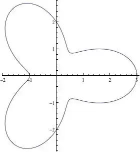

(The following example avoids piecewise definitions; but there is nothing "special" about it.)
Consider the curve $\gamma$ with polar representation $$r=r_0(\phi):=2+\cos(3\phi)\ ,$$ which looks like a clover leaf, see the following figure. This curve has a length $L_0$ and encloses an area $A_0$.
We now set up a perturbation of $\gamma$ in the form $$r=r(\phi):=r_0(\phi)+ a + b\cos(3\phi)+c\cos\phi$$ with small parameters $a$, $b$, $c$. Define $$L(a,b,c):=\int_0^{2\pi}\sqrt{r^2(\phi)+r'^2(\phi)}\ d\phi, \qquad A(a,b,c):={1\over2}\int_0^{2\pi}r^2(\phi)\>d\phi\ .$$ The quantities $$a_{11}:={\partial L\over\partial a}\biggr|_{(0,0,0)},\quad a_{12}:={\partial L\over\partial b}\biggr|_{(0,0,0)},\quad a_{21}:={\partial A\over\partial a}\biggr|_{(0,0,0)},\quad a_{22}:={\partial A\over\partial b}\biggr|_{(0,0,0)}$$ are obtained by differentiation under the integral sign and putting $(a,b,c)=(0,0,0)$. Numerical integration then gives $$a_{11}=4.4197,\quad a_{12}=9.3105\ ,$$ whereas the other two can be computed explicitly: $$a_{21}=4\pi,\quad a_{22}=\pi\ .$$ At any rate, one has $\det[a_{ik}]\ne0$. From this we can draw the following conclusion:
The system of equations $$L(a,b,c)=L_0, \quad A(a,b,c)=A_0$$ has the solution $(0,0,0)$. Therefore it can be solved for $a$ and $b$ in the neighborhood of $(0,0,0)$, which means that there are two $C^1$-functions $c\mapsto \alpha(c)$, $c\mapsto\beta(c)$ with $\alpha(0)=\beta(0)=0$, such that $$L\bigl(\alpha(c),\beta(c),c\bigr)=L_0,\quad A\bigl(\alpha(c),\beta(c),c\bigr)=A_0$$ for all $c$ in a neighborhood of $0$.

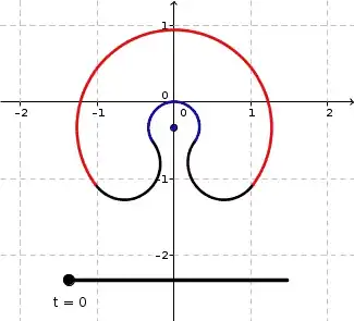

Though still not satisfying the OP's desire for smoothness of higher degree, the following construction turned out to be simpler than my initial analysis had predicted:
All the curves in this family have a perimeter of $L=10$ and an area of $A=4$. The $\color{blue}{\text{blue arc}}$ has radius $r$ variyng as a function of $t$. The parameter $t$ is not really important here - it just reparametrizes $r$ to make the animation look nicer. The $\color{red}{\text{red arc}}$ has radius $r+d$ so that $d$ is the width of the section between the $\color{blue}{\text{blue arc}}$ and the $\color{red}{\text{red arc}}$. The two black half circles both have $d$ as diameter. The angle $\theta$ denotes the common angle of the $\color{blue}{\text{blue arc}}$ and $\color{red}{\text{red arc}}$ measured in radians.
In my initial analysis, I fixed some $r$ and tried to set up equations involving $d$ and $\theta$ as variables in order to match $L$ and $A$. I quickly found that $$ \begin{align} 2\theta(d^2+2rd)+\pi d^2&=4A&&&(1)\\ \text{and}\\ \pi d+\theta(2r+d)&=L&&&(2) \end{align} $$ and solving $(2)$ for $\theta$, substituting that into $(1)$, and rearranging a bit then yields $$ (2 r+d)(\pi d^2-2L\cdot d+4K)=0 $$ where it turns out (btw. applying the zero product rule) that only the solution $$ d=\frac{L-\sqrt{L^2-4 \pi K}}{\pi} $$ has both $d$ and $\theta$ positive. Surprisingly (I find it so), the width $d$ does NOT depend on $r$ anymore in this solution. So in effect only $\theta$ varies with $r$. Though the above construction is NOT a family of $C^2$ curves (or higher), but just $C^1$, it still has the advantage of looking very nice in the way it bends and transforms, in my opinion.
BTW. I have chosen $r\in[1/3,2]$ in the animation above by defining $r=\dfrac{0.4}{1.2-s}$ and $s=\dfrac{1 + \sin\left(\pi (t-0.5)\right)}{2}$ and letting $t$ run through the interval $[0,1]$. The sine function was to make the change slow down near the extreme values of $t$ to make the bending speed change more smoothly.

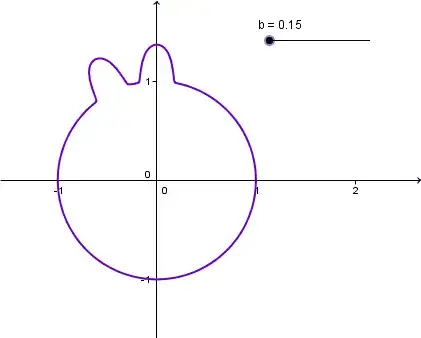

Circle with two bumps
Let $f$ be your standard bump function $$ f(x) = \begin{cases} e^{-\frac{1}{1-x^2}}, &|x| < 1\\ 0, &\text{otherwise} \end{cases} $$ Let $g(x) = f(5x)$ (this makes your bump narrower).
For $b \in [0, 1]$ (but not too close to 0), consider the curve: $$ r(t) = 1 + g(t-\frac{\pi}{2}) + g(t-\frac{\pi}{2} - b\pi) \quad \text{for } t \in [0, 2\pi] $$
All of these curves have the same area and perimeter and are also smooth (though they are technically piecewise-defined).

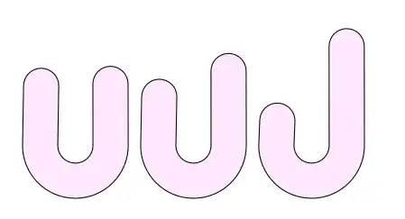

The following example is not very sophisticated, but does the job:
Take a square of side length $a>0$, and round off its corners using small circular arcs of radii $\rho_i>0$ $(1\leq i\leq 4)$, $\rho_3\ne\rho_4$. The circumference of the resulting shape computes to $$L=4a-\left(2-{\pi\over2}\right)\sum_i\rho_i\ ,$$ and its area to $$A=a^2-\left(1-{\pi\over4}\right)\sum_i\rho_i^2\ .$$ The system of equations $$\eqalign{f({\bf r})&:=\qquad r_1+r_2+r_3+r_4={4a-L\over 2-{\pi\over2}} \cr g({\bf r})&:=\qquad r_1^2+r_2^2+r_3^2+r_4^2={a^2-A\over 1-{\pi\over4}}\cr}\tag{1}$$ can be solved for $r_3$, $r_4$ using the implicit function theorem (or even explicitly): Since $$\det\left[\matrix{{\partial f\over\partial r_3}&{\partial f\over\partial r_4}\cr {\partial g\over\partial r_3}&{\partial g\over\partial r_4}\cr}\right]_{(\rho_1,\rho_2,\rho_3,\rho_4)}=2(\rho_4-\rho_3)\ne0\ ,$$ the system $(1)$ is in a neighborhood of $(\rho_1,\rho_2,\rho_3,\rho_4)$ equivalent to $$r_3=\phi(r_1,r_2),\quad r_4=\psi(r_1,r_2)$$ with $C^1$-functions $\phi$ and $\psi$. In this way we obtain a two-dimensional family of "rounded squares" having "corner radii" $r_i$ $(1\leq i\leq 4)$. All these "rounded squares" possess the same circumference $L$ and the same area $A$.
