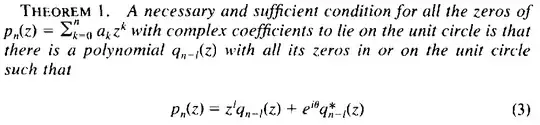

This is not a answer. I just want to use the space and easy-to-edit feature in the "Answer" section to type the equations.
You did not specify the relation of the modulus of the coefficients $a_n$. If they happen to be cup-shaped, then you may use a theorem by Chen (J. of Math. Anal. and Appl. vol 190, 714-724 (1995)).
By cup-shaped, I mean
$$|a_0|\ge |a_1| \ge \cdots \le |a_{N-2}| \le |a_{N-1}|$$
In your case, we have (assume $N=2n+2$) $$P(z) = \sum_{k=0}^{2n+1}a_kz^k=z^n q(z)+q^*(z)$$
where $$q_n(z)=\sum_{k=0}^na_{n+k+1}z^k$$ $$q_n^*(z)=\sum_{k=0}^n a_kz^k$$
If $N=2n+1$, then we define $Q(z)=(1+z)P(z)$ and treat $Q(z)$ in a similar fashion.
mike
  • 5,692
  • $|a_n|$ is of the form $1 - \beta sin(n)$ i.e. varying sinusoidally from $0 \leq n \leq N-1$. So they are not cup-shaped.
    As for the approach you mentioned, to ensure that $q_n(z)$ has all its zeros in or on the unit circle modulus of its coefficients have to be monotonically increasing or equal and this is satisfied when the $|a_n|$ are cup-shaped. Is my understanding correct?
    – sauravrt Jul 15 '14 at 14:12
    Yes. But I got $|a_n|^2=1 + \beta^2 - 2\beta \cos((1/2)(1 + 2n - N)\pi(u_0 - u_1))$. I assume that you verified numerically that all the roots of $P(z)$ are on the unit circle. Right? – mike Jul 15 '14 at 16:32
  • Yes I did verify numerically that all roots like on unit circle. Regarding $|a_n|^2$ I was only trying to imply that its form is 1 + some sinusoidal term and that it didn't form the cup shape. – sauravrt Jul 16 '14 at 11:22
  • I see. If the coefficients are not cup-shaped, then I am not aware of any general method to prove such polynomials having onlyreal zeros. – mike Jul 16 '14 at 14:50
