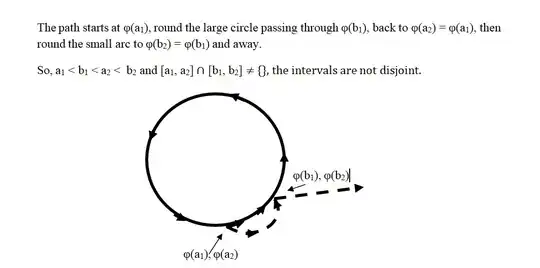

The problem with that proof is that though the intervals of $\mathcal{C}$ are indeed proper and closed, they are not necesarily disjoint. I can't reproduce the drawing here but it is not too difficult to show a curve in $\mathbb{R}^{2}$ with two double points $x,y$ such as $\phi(a_{1})=\phi(a_{2})=x$, $\phi(b_{1})=\phi(b_{2})=y$, and $a_{1} < b_{1} < a_{2} < b_{2}$.

Here's a diagram ...
Since the intervals are not necessarily disjoint they aren't necessarily countable either.

  • I added the diagram - hope it's correct. – Tom Collinge Oct 09 '19 at 14:26
