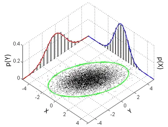

While reading this answer, I clicked on the provided link to this Wikipedia page. The main article image shows the PDF of a 2D multivariate normally distributed system:
In the image, the $3\sigma$ ellipse is marked in green. Since the two variable coordinates x and y are normally (and thus symmetrically) distributed around the X and Y axes, I'd expect the ellipse's major and minor axes to be aligned with the X and Y axes. The image shows a slightly rotated ellipse.
Why is the ellipse rotated? Is it just a drawing error?

  • $X$ and $Y$ are not independent. – Hans Lundmark Jun 18 '14 at 15:10
  • @HansLundmark - where is this limitation mentioned in the article? Or, is it just your possible explanation to the rotation of the ellipe? – ysap Jun 18 '14 at 15:21
  • @ysap - Although it is not explicitly stated in the Wikipedia, it does appear that @HansLundmark is correct. The random variables are not independent.

  • @Jubbles - I am not familiar w/ R, however, I don't need that code to realize that dependent variables can rotate the ellipse. An extreme case is when x = y, so the ellipse is reduced to a 45deg straight line. – ysap Jun 19 '14 at 01:50
  • @HansLundmark - OK, I'll take it that this is the cause for the rotation in the image. If you make this an answer, I'll up-vote it. – ysap Jun 19 '14 at 01:50
  • All right, I wrote an answer (with a little explanation too). – Hans Lundmark Jun 19 '14 at 06:28
The random variables $X$ and $Y$ are not independent. As you can tell from the following line in the source code on the image page, there is a correlation between them:
CovMatrix = [1 0.6; 0.6 2];
(The off-diagonal entries in the covariance matrix are non-zero.)
