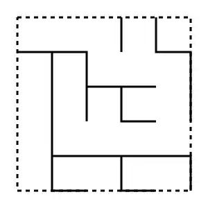

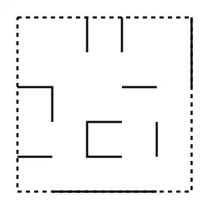

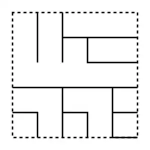

If I were on the plane, then there are relatively straightforward ways of doing this: for instance, for each cell, place a wall randomly on either that cell's south or east edge. With probability 1 this will create a spanning tree of the plane - it's not a 'random' spanning tree (in particular, of course, it's impossible for any cell to have both its south and east sides 'walled', which I imagine happens with probability 0 for a random spanning tree of the plane) but it's a tree, even so. For instance, here are two $5\times 5$ grids of cells with their east or south sides randomly walled:
rectangular maze another rectangular maze

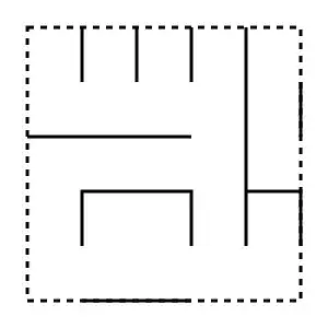

Similarly, if the generation process uses a 3-sided coin with equal probabilities of drawing a south wall, east wall or no wall, then the resulting grids aren't spanning trees (there can exist multiple disjoint paths between nodes), but they still clearly have the sort of distance multiplication I'm looking for:
a looser rectangular maze another loose rectangular maze

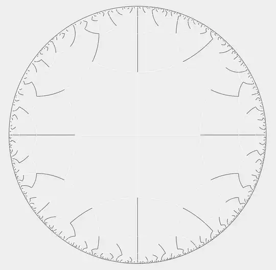

Here's an image of a maze on the $[5,4]$ tiling of the hyperbolic plane created in this manner, visualized using the Poincaré disk model. The straight segments, which lead neither away nor towards the centre, are all walled, except for the innermost ones. For the arced segments, each tile "owns" the ones that lead towards the centre from that tile, i.e., the ones for which the tile is in the interior of the circle of which the segment is an arc. For each tile, exactly one of the segments it owns is open, chosen randomly with uniform distribution, and the others are walled.
hyperbolic maze

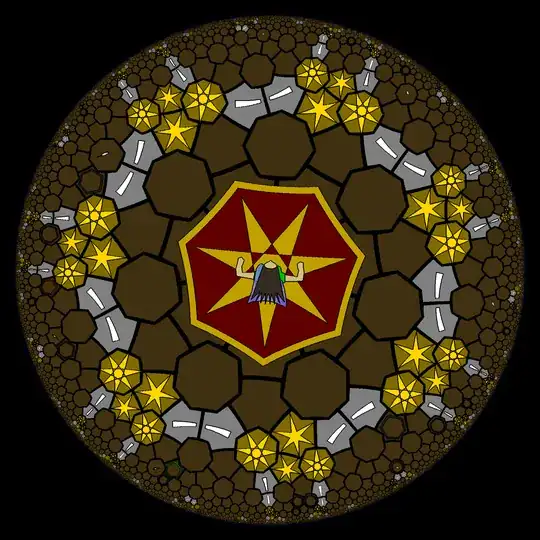

Mazes can be created in the hyperbolic plane very easily: you only need to ensure that the starting and goal points are both reachable from infinite regions, and connect the cells randomly with high enough probability, and it is guaranteed that the maze is solvable. I am not sure whether this is exactly what Steven Stadnicki wants, but it does generate interesting mazes. I am using this in HyperRogue -- the idea is the easiest to explain with the Princess Quest maze.
This is the periodic pattern used, consisting of heptagonal rooms (which have seven gates) and infinite tree-like corridors. Gates are randomly opened or closed; if they are closed, they can be opened by stepping on nearby green plates (which may not exist, or may exist on the other side). You typically start 100 steps away in the 12 o'clock direction, and your goal is to free the Princess by stepping on the green plate (at 7 o'clock on the picture).
It is guaranteed that it is possible to free the Princess:
  • the opening plate always appears in a corridor, so its connected component is infinite (and similarly for the starting point),
  • if you consider the obstacle (i.e., the Princess's prison and all the other heptagonal rooms which you have to circumvent while trying to reach her), it has a tree structure: to circumvent the given heptagonal room $H$, you may need to also circumvent each of the 6 heptagonal rooms adjacent to $H$ (6 because we are not including the parent). The probability that a given room has child rooms depends on the probabilities of open/closed gates and opening plates occuring. This probability is high enough to make the maze interesting, but low enough to ensure that the obtained branching process generates a finite tree with probability 1. (Hyperbolic geometry is important in this argument -- otherwise there would be cycles in the obstacle graph; well, I guess it could be adjusted to Euclidean geometry, but the situation is much more complicated, and the generated mazes are less interesting IMO.)

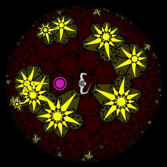

This is the Yendor Quest in Hell: you have to reach a cell 100 steps away, to find the key to unlock the purple Orb of Yendor. This construction of obstacles is very simple (just pick some tiles randomly as the centers of "big stars", and all the tiles adjacent to them are impassable), but a similar reasoning guarantees that it generates a solvable maze. (HyperRogue does not guarantee that the starting/key regions are infinite, because it is extremely unlikely anyway that they are finite, but it would be easy to guarantee this.)
