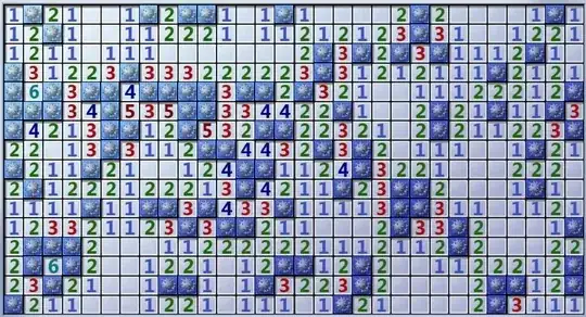

This is just out of curiosity. Suppose the game has $m \times n$ boxes for positive integers $m$ and $n$. How can we make the sum of the numbers on a finished game the most?
There are two extreme cases, i.e., no mine, or each box is a mine. In these extreme cases, no number is written. Thus the sum is $0$. So I think maybe there exists a maximum number for the sum.
