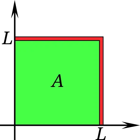

Consider this picture:
Derivative of area of is square is twice the length of its side
Here, the green square is the square of area $A=L^2$ and red line is its increase.
When you increase the length $L$ by $dL$, the area $A$ gets increased by $2LdL$. So, to answer your question, significance of $2L$ is that it is the length of the red line on the picture ($dL$ is its width).
Danijel
  • 1,668
    This may be confusing since the area of the red part is actually 2LdL + dL^2... – Heisenberg Apr 30 '14 at 16:33
  • @Anh Indeed, but $(dL)^2$ part becomes infinitely smaller than $2LdL$ in the limit when $dL$ becomes infinitesimal, so it can be safely ignored.
    It matters for the second derivative though.
    – Danijel Apr 30 '14 at 17:01
    @Danijel, you should add that to your answer, to make it more complete. Still, +1 for the picture – JMCF125 May 01 '14 at 12:38
