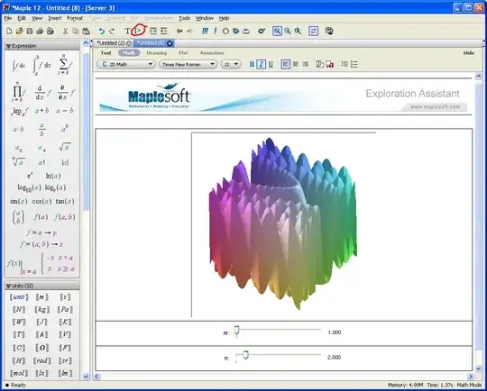

1clicking the [> icon with cursor at the end of the line above where you want to insert works for me – Ryan Vitale Apr 14 '14 at 23:31

Figured it out... Insert>Execution Group>After cursor (cmd-J) – HeliosPanoptes Apr 15 '14 at 01:10

With your cursor, click the place you would like to enter your new line. Then, near the top of Maple, there should be a toolbar with a button that looks like "[>". If you press this button, it will start a new line. I posted a picture below; the button circled in red is the one you should press.
