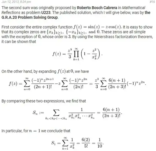

This is not an answer of mine It is an image of a solution with a higher degree of generalization (with references to the original question) that I have found on AOS [Explanation : As AOS site is no longer active, I fear the link I give here will be disactivated] (pseudo of the author : PolyaPal). This thread is as well mentionned by @jmerry.
Independant remark : function $f$ can be written using Bessel function $J_{3/2}$ (see this).
