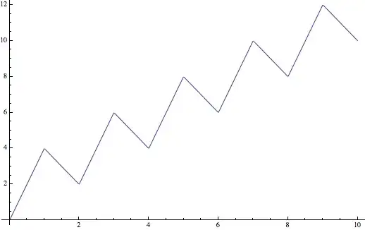

Here's a continuous solution:
$$ f(x) = \begin{cases} 4x-3\lfloor x\rfloor & \text{when $\lfloor x\rfloor$ is even} \\ 3\lfloor x\rfloor + 3 - 2x & \text{when $\lfloor x \rfloor$ is odd} \end{cases} $$
This takes on the values $0,4,2,6,4,8,6,10,8,\ldots$ at integer $x$ and interpolates linearly between them.
Any even number $2m$ is hit at $f(2m)$ (a local minimum), $f(2m-\frac32)$ (the middle of an increasing line segment), and $f(2m-3)$ (a local maximum). All other numbers are hit by a point in an increasing line segment, then a decreasing one, and finally another increasing one.
A smoother function with the same overall shape would be $g(x)=ax+\sin x$, except the coefficient $a$ has to be just right in order to get the local maxima and minima to coincide, and I'm too lazy to figure out what it should be.

@Henning Makholm: Just looking at the graph the first half of the first segment does not seem to attain every height 3 times (visually). That is, values $y<2$. Perhaps you mean the graph extends to negative region too? – P Vanchinathan Apr 02 '14 at 00:25
3@PVanchinathan: The function is $\mathbb R\to\mathbb R$; the graph (contributed by Omnomnomnom) shows it only for $x$ between $0$ and $10$, but it is to be understood that it extends indefinitely below and above that interval. – hmakholm left over Monica Apr 02 '14 at 00:30
