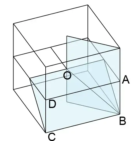

Following Nich Matteo's answer, I find this's straightforward to find $\rho_0, \rho_1, \rho_0$ in a cube.
$\rho_0$ is reflecting by plane OAD.
$\rho_1$ is reflecting by plane OBC.
$\rho_2$ is reflecting by plane OAB.

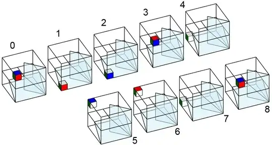

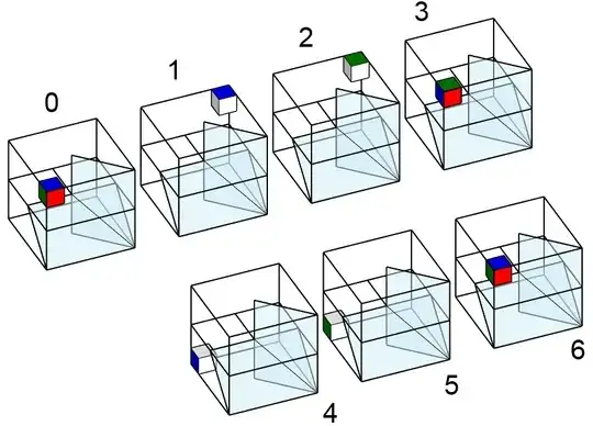

$ (\rho_1 \rho_2)^3=1$ can be illustrated by the following six reflections:
enter image description here $ (\rho_0 \rho_1)^4=1$ can be illustrated by the following 8 operations: enter image description here
