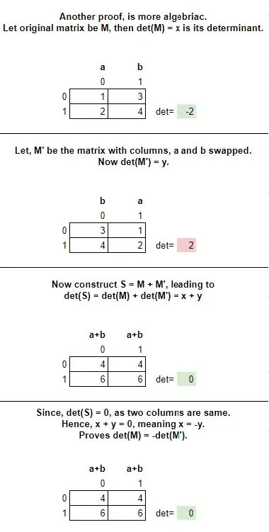

The approach suggested by @NanoShaw is the easiest to understand. I cover this in a video explainer as well: https://www.youtube.com/watch?v=glxl6U3gqNQ
However, a much simpler approach is to consider the following:
Let original matrix be $M$, then $det(M) = x$ is its determinant.
Let, $M'$ be the matrix with columns, $a$ and $b$ swapped. Now $det(M') = y$.
Now construct $S = M + M'$, leading to $det(S) = det(M) + det(M') = x + y$
Since two columns $a$ and $b$ of $S$ are same with value $a+b$, $det(S) = 0$. Hence, $x + y = 0$, meaning $x = -y$. This proves $det(M) = -det(M')$.
