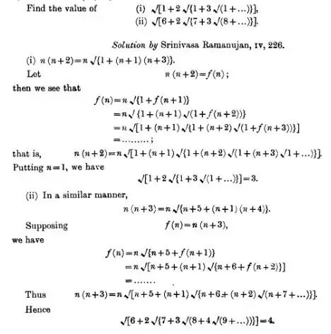

This is the special case $\rm\ x,\:n,\:a = 2,\:1,\:0\ $ in Ramanujan's second notebook, chapter XII, entry 4:
$$\rm x + n + a\ =\ \sqrt{ax + (n+a)^2 + x\sqrt{a(x+n) + (n+a)^2 + (x+n) \sqrt{\cdots}}} $$
Below is Ramanujan's solution of the given special case - which was submitted to a journal in April 1911. Note that his solution is incomplete (exercise: why?). For further discussion see this 1935 Monthly article, Herschfeld: On infinite radicals. It also appeared as Problem A6 on the 27th Putnam competition, 1966. Vijayaraghavan proved that a sufficient criterion for the convergence of the following sequence $\ \sqrt{a_1 + \sqrt{a_2 +\:\cdots\: +\sqrt{a_n}}}\ \ $ is that $\rm\displaystyle\ \ {\overline \lim}_{n\to\infty}\frac{\log{a_n}}{2^n}\ < \infty\:.\ $
alt text
