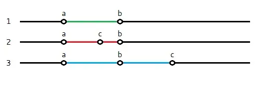

As others have pointed out, you should prove this by using the triangle inequality. I also think you should try to understand the problem intuitively so I drew a picture:enter image description here
$|a-b|$ represents the distance between the points $a$ and $b$ on the number line. If $c$ is between $a$ and $b$, or is equal to either $a$ or $b$, then the distance from $a$ to $c$, which is $|a-c|$, plus the distance from $c$ to $b$, which is $|c-b|$, will equal the total distance from $a$ to $b$. In other words, the length of the two red line segments in case $2$ equals the length of the green line segment in case $1$. If $c$ does not lie between $a$ and $b$, as in case $3$, then the distance from $c$ to either $a$ or $b$ must be greater than the distance from $a$ to $b$.
Note that the above is in not a proof but it can help you understand the problem.

  • Thank you , I really appreciate you taking the time to draw a picture. I do understand much better now. Thanks again. – Achilles Mar 11 '14 at 20:21
