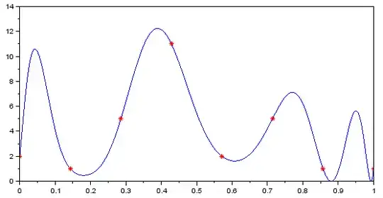

A cheap and dirty solution is to interpolate $(x_i,\sqrt{y_i})$ and square the interpolating function. If you interpolate with a polynomial, you'll have a nonnegative polynomial of twice the degree. The obvious drawback is that the squared function will have somewhat unnatural behavior in the regions where the interpolant was negative before squaring. Like on the right side of the graph here:
interpoly

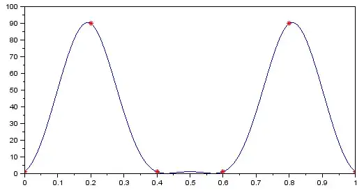

If you use spline interpolation (e.g., cubic spline), the behavior of interpolant is much better; it takes a bit of effort to produce an example where the interpolant becomes negative. Here I started with the values 1 90 1 1 90 1 at equally spaced points, interpolated their square roots with a natural cubic spline, and squared the spline:
spline

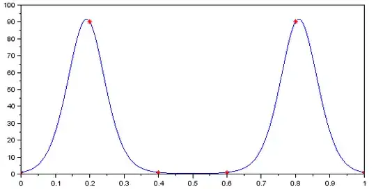

The bump around 0.5 is unpleasant. It would be better to use logarithm instead of square root, but of course then we don't have a piecewise polynomial as a result:
expoly
