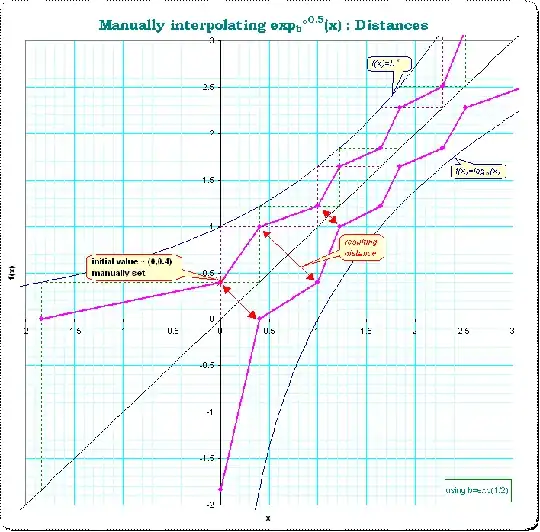

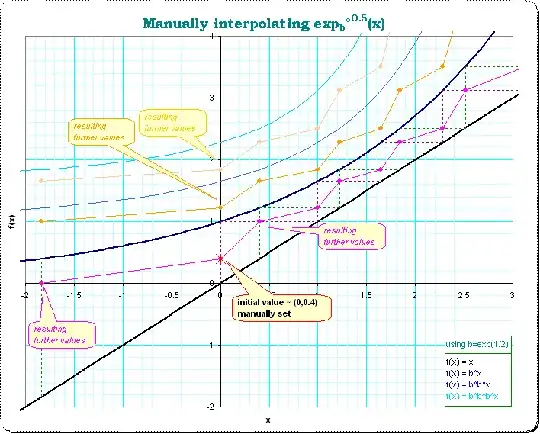

To show the effect of different initializations, which are so nicely worked out by @Plop , I made some pictures using excel. To have more information in the graphs I used however the function $ \small f(x)=h(h(x)) = b^x $ with $\small b=\exp(0.5)$ instead of $\small b=e $. These pictures are in (see: Excel_presentation) ; it is just a quick presentation; use only the first seven sheets. Here are three of that pictures so that you have an idea what I'm talking about: enter image description here
It shows the functions $ \small f(x)=x, f(x)=b^x, f(x)=b^{b^x}, f(x)=b^{b^{b^x}} $ as strong curved lines, and the estimated 0,5,1.5,2.5 - iterated versions as far as computable from the initial guess (that a-value in Plop's post). For this the dottest lines were used to construct the subsequent values of the orbit. (If I recall right then this iterative construction was already used by G.H.Hardy, but I don't know whether he was the first one)
The goal of a good choice for a is then to make the magenta line for the half-iterate as smooth as possible.
But how to define/operationalize "smooth" with such a discrete orbit? One idea is to take the distances to the according coordinates of the mirrored function $\small f°^{-0.5}(x) $, see the next picture.

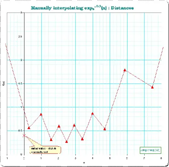

The distances show a sequence of erratically changing lengthes. This is shown in the next image.

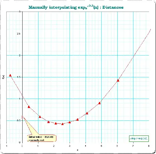

We see, that a better choice of the initial value of a could provide a "smoother" version; instead of initializing with $\small (0,f° ^{0.5}(x))=(0,0.4) $ we use $\small (0,f° ^{0.5}(x))=(0,0.58) $ and get a far better curve of distances:
A set of 3 initial guesses is in the provided link of the Excel-html-output as given in the first link . The first three pictures are of the first type, then there is one picture explaining the distance-idea, and then the next three pictures are of the latter type. The following pictures are not of interest, they are just working material. You can use the tabstrip at the bottom of the image to navigate.

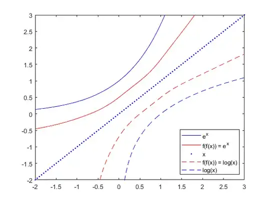

Here is a simple program for the above, and here is a plot:

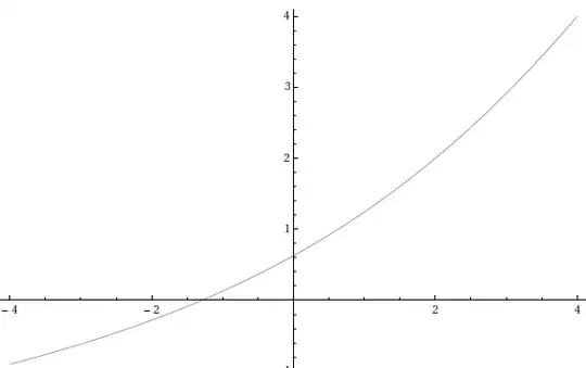

Plot of ln, exp, and their functional square roots
