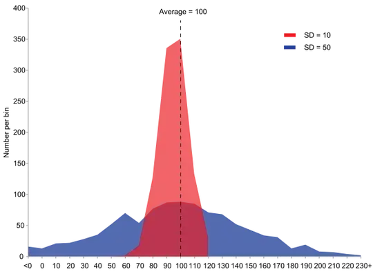

We know that standard deviation (SD) represents the level of dispersion of a distribution. Thus a distribution with only one value (e.g., 1,1,1,1) has SD equals to zero. Similarly, such a distribution requires little information to be defined. On the other hand, a distribution with high SD requires many bits of information to be defined, therefore we can say its entropy level is high.
http://upload.wikimedia.org/wikipedia/commons/thumb/f/f9/Comparison_standard_deviations.svg/612px-Comparison_standard_deviations.svg.png
So my question: is SD the same as entropy?
If not, which relationship exist between these two measurements?

They are not the same. If you have a bimodal distribution with two peaks and allow the spacing between them to vary, the standard deviation would increase as the distance between the peaks increases. However, the entropy $$H(f) = -\int f(x) \log f(x) dx$$ doesn't care about where the peaks are, so the entropy would be the same.
