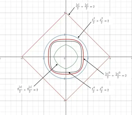

Honestly, it's just really easy to compute.
While there are other methods that may give better answers in certain situations, Least Squares with a much simpler algorithm. It just involves constructing a matrix, where each element is a sum. Then we can use Row Reduction Echelon Form to find the coefficients.
This simplicity means that it can be used on cheaper hardware (like your calculator) and it means it's pretty fast on modern cpu's.
On top of that, it's used to find the coefficients of polynomials and rational functions, two function forms that are extremely fast and easy to compute, and which we can make more accurate by just adding another term.
Honestly, I don't know if it is the theoretical optimal methods, but I do know that practically its one of, if not the easiest to use.
Here's a visualization of some of the alternative error functions one could use.
Clockwise: Absolute error, Square error, Absolute cubed error, Absolute 4th power error, Absolute exponential error.
Note how the non-square errors exaggerate different error combinations.
Interactive version here: https://www.desmos.com/calculator/eugeucw7te
