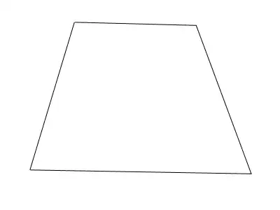

I am writing a program where I would like to allow the user to draw 4 connecting lines, such as:
image of arbitrary quadrilateral
And convert this shape into a 3D plane. Is this possible? Is there an existing algorithm to do so? If not, any idea of the steps I should be taking?

  • How exactly should the quadrilateral describe a $3D$ plane? I assume the shape in $3D$ is supposed to be a rectangle, but is it supposed to be a square, as well? I don't think there is a unique projection that would render a rectangle to the quadrilateral above.
    Given the aspect ratio of the rectangle, then there is a unique (up to scaling) transformation that yields the given quadrilateral.
    – robjohn Sep 08 '11 at 20:43
  • What is your end goal? If you want the user's (2D) shape to be interpreted as a plane in 3-space, I think you're going to have to make some additional assumptions. As it stands, the sketch you provided could be a rectangle angled away from the camera, or a trapezoid parallel to the plane of the camera. More specifically I suppose, what role does the rectangle at at (0,0,0) play? – Andrew Christianson Sep 08 '11 at 21:06
  • Yes, the drawn shape is assumed to be a rectangle. What I'd like ideally is to find a transformation that will transform the square at [0,0,0] to give the projected outline drawn by the user. Does that help? – Groky Sep 08 '11 at 21:17
  • I think it is a computer vision problem. The user drawn outline is the perspective projection of the 3D rectangle. But if the camera is centered at (0,0,0), how can the 3D rectangle be too? You need to determine the image plane of the camera first. The user drawn outline is on the image plane. Usually the image plane can be choose as $z=-1$. – Shiyu Sep 09 '11 at 01:22
  • Ah sorry Shiya - yes, of course the transformation will involve a translate away from the camera. You're right though when you say "The user drawn outline is the perspective projection of the 3D rectangle". This is the problem I'm attempting to solve. Please feel free to ignore the other specifications if you know how to solve this problem! – Groky Sep 09 '11 at 08:24

As Shiyu mentions in the comments, this is a well-studied computer vision problem. A key term for search is homography. E.g., here is the Wikipedia article. This topic is covered in most textbooks on computer vision. Here is one: Geometric Computation for Machine Vision by Kenichi Kanatani. See especially p.59, where he provides an algorithm for "camera registration" (another key search term) whose first step is: "Take an image of a rectangle placed in the scene." Which is exactly your situation.
In QuickDraw GX, the graphics system was $2D$, but used $3\times3$ perspective matrices for transformations.
A $2D$ point is imbedded in $3D$: $$ [x,y]\mapsto[x,y,1] $$ and a $3D$ point is projected to $2D$: $$ [x,y,z]\mapsto\left[\frac{x}{z},\frac{y}{z}\right] $$ A perspective mapping imbeds a $2D$ point in $3D$, performs a $3\times3$ matrix multiplication, then projects the $3D$ result back to $2D$: $$ M:\left[\begin{array}{cc}x&y\end{array}\right]\mapsto\left[\begin{array}{ccc}x&y&1\end{array}\right]M=\left[\begin{array}{ccc}u&v&w\end{array}\right]\mapsto\left[\begin{array}{cc}\frac{u}{w}&\frac{v}{w}\end{array}\right] $$ Since this is a perspective mapping, it can map any $4$ points (no $3$ of which are collinear) to any $4$ points. Given $4$ points $[x_n,y_n]_{n=1}^4$, compute $$ \left[\begin{array}{ccc}d_1&d_2&d_3\end{array}\right]=\left[\begin{array}{ccc}x_4&y_4&1\end{array}\right]\left[\begin{array}{ccc}x_1&y_1&1\\x_2&y_2&1\\x_3&y_3&1\end{array}\right]^{-1} $$ and define $$ M_{[x\;y]}=\left[\begin{array}{ccc}d_1x_1&d_1y_1&d_1\\d_2x_2&d_2y_2&d_2\\d_3x_3&d_3y_3&d_3\end{array}\right] $$ Then, for $4$ other points $[u_n,v_n]_{n=1}^4$, we have $$ M_{[x\;y]}^{-1}M_{[u\;v]}:\left[\begin{array}{cc}x_n&y_n\end{array}\right]\mapsto\left[\begin{array}{cc}u_n&v_n\end{array}\right] $$ Now to apply this to your problem. Using the rectangle and quadrilateral mentioned above, generate the $3\times3$ perspective mapping taking the rectangle to the quadrilateral and take the cross product of the first two rows. That will be the perpendicular to the plane for the quadrilateral. However, without more information about the positioning in $3D$, I don't think you can get much more.
