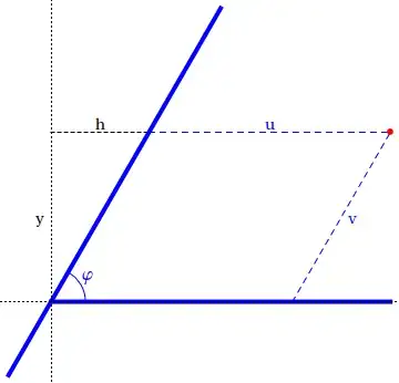

I'll make the assumption that:
The oblique coordinate system $(u,v)$ with angle $\varphi$ and the Cartesian system $(x,y)$ share an origin.
Axis $u$ and $v$ share the same unit of lengh with the Cartesian system.
Consider the following diagram:
We have at once the relationship $x=u+h$. The acute angle formed by the $v$-axis and $h$ is $\varphi$, since alternate interior angles in a pair of parallel lines are congruent. We use trigonometry to deduce the relation $y=h\tan\,\varphi$. Eliminating $h$ gives the equation for $u$: $u=x-y\cot\,\varphi$.
To find an expression for $v$, we see that this length is equal to the length of the hypotenuse of the right triangle with legs $y$ and $h$. This leads to the equation $y=v\sin\,\varphi$. Solving for $v$ gives the equation $v=y\csc\,\varphi$.
Thus, the conversion formulae from Cartesian to oblique coordinates with angle $\varphi$ are
$$\begin{align*}u&=x-y\cot\,\varphi\\v&=y\csc\,\varphi\end{align*}$$
For completeness, the formulae for converting from oblique to Cartesian coordinates are
$$\begin{align*}x&=u+v\cos\,\varphi\\y&=v\sin\,\varphi\end{align*}$$
